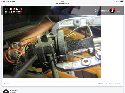

It appears the stalk rotates and is somehow held into a cam by friction only . So it does indeed just pull out . I can re insert it easily but it getting difficult for it to grip the cam .
The cam has multiple facets that I assume close ( and open ) contacts as it rotates .
Some one on F chat suggested the cam s housing fractures , the yoke that holds it ?
Any how a few pics .E3B1A394-056F-4F0E-B16F-78E992EACF71.jpegBAE649C7-241C-43D2-A69F-A8CE4E7E2E94.png
It’s the switch with the rivets in ^ .
After removing the steering wheel ( 28 mm ring nut required) ….has anyone separated the indicator switch from the light stalk unit ?
The yoke + the cam .
Has any one disassembled the stalk light down to this ? F chats talks of drilling out rivets and re fixing with self tappers ?
I was wondering just to dab a bit ( tiny smear ) of glue on the stalk top and simply re inert it , wait to set …..based on the theory the stalks not gripping the cam , so just turning .

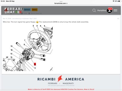

Finally internet chaff talks of Lancia delta having the identical whole column switch gear ?
Does anyone know of the cross part ? , They would have picked something out of the Italian parts manufacturers around Moderna .

Bear in mind Marenello parts only do the whole column @ £2000 and most EU parts guy asked €3500 .
