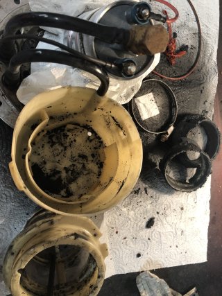

5. There is no fuel pump sound while turn the key. I can manually run the pumps with direct +12v. Both pumps are ok, but I don't know if the pumps are kicked together with starter.
