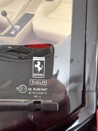

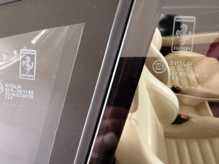

On my car all the original windows are marked up as Ferrari and the new one fitted by the main dealer is marked exactly the same. Pretty sure it should come like this from Maranello Classic Parts (not certain but would think it will) but I'm guessing there's a chance it might not from whoever Autoglass are suplied by.
