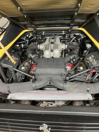

Ok see this deck above . Under the grills is a drip tray . This tray prevents water in this example dripping on the plugs leads and cam cover , which if that occurred = not good .
Ok once again another ex …….see the drip tray protecting the throttle position sensors on the atop of the butterfly valves .Note they have additional rubber boots around the plugs and further rubber booted plugs dotted around under the more open , none protected bits under the plane open grills on this 348 .
