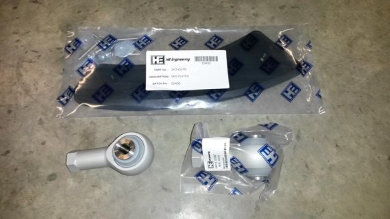

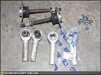

Rear Tie Rods
The Hill Engineering rear tie rod ends arrived. They are stainless steel ball joints encased within a billet aluminium end. The original Ferrari ends are plated ball joints in a forged alloy end. Ferrari fitted the arms in 2011 as a complete assembly and they hadn't used any anti-sieze compond which I always find vital when dealing with alloy threads. I had to cut off one of the original ends as it wouldn't budge even with heat applied. I've also bought new bolts to secure the end plates.
Assembly fitted.

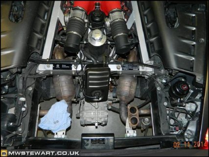

I removed the A/C compressor to gain better access to the N/S exhaust nuts, and one of the three securing bolts sheared off in the block. Thank God it was the lower bolt (see arrow) which is easy to access otherwise it could have been a huge amount of work to rectify! It turns out that Ferrari use a grade 12.9 bolt for one of the three, with the others being 8.8! Combine that grade of bolt with an alloy thread in a hot engine block without any anti-sieze and you have a potential recipie for disaster. I decided to Helicoil the mount to make it better than original. I also replaced the bolts with new ones this time all in grade 12.9.

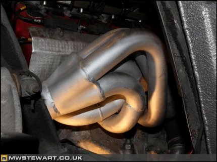

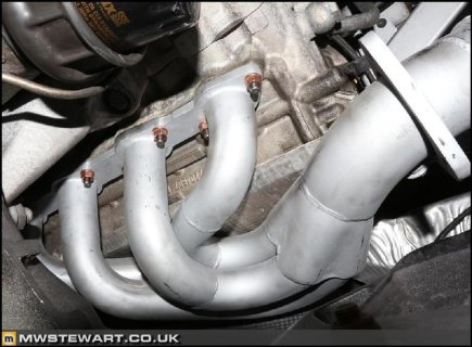

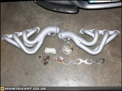

Manifolds fitted

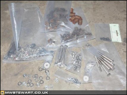

Manifolds coated, and new studs from Ferrari. They are only 71p each so it makes sense to replace them. The nuts were from VW as it happenend; most manufacturers now use M8 exhaust studs with the smaller 12mm hex head.
It took me twenty minutes to fit the new manifolds which is in stark contrast to the four hours it took to remove the stock manifolds! The replacements fit well - a little tight around the studs compared to OEM, but that's no bad thing - so at this point they are looking to be a complete bargain. Let's see how they hold up to regular use.

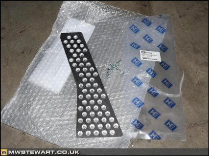

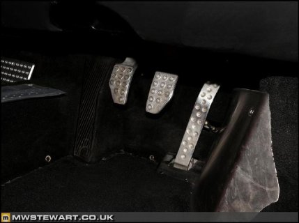

Hill Engineering Foot Rest
I ordered this at the same time as the ball joints. The standard Ferrari foot rest is just a black rubber peice stuck onto an aluminium back plate. The Hill piece matches the rest of the pedals.
Standard rest:
Hill Engineering were brilliant to deal with and the service was great, and fast. The products are excellent quality so I certainly recommend them.

I finished off the manifolds this evening and gave them a quick test: no leaks. I replaced all of the undertray and wheelarch fastenings with stainless versions - there are a lot of them.

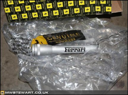

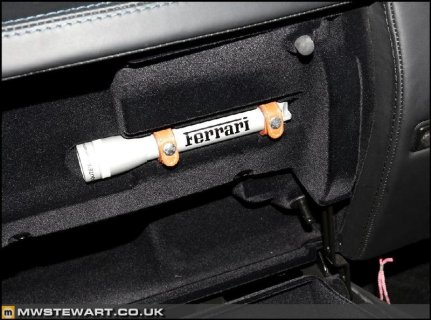

There is a recess and nice pair of tan leather straps in the glove box to mount a Ferrari Maglite. My car was missing this so whether it is an optional extra or previous owners just keep them for a memento, I don't know, but they are probably the most expensive Maglite mini there is :)
I think it's a nice touch.
mine too.

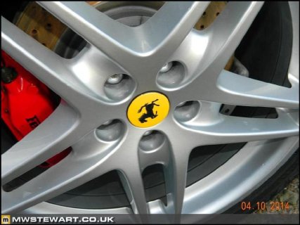

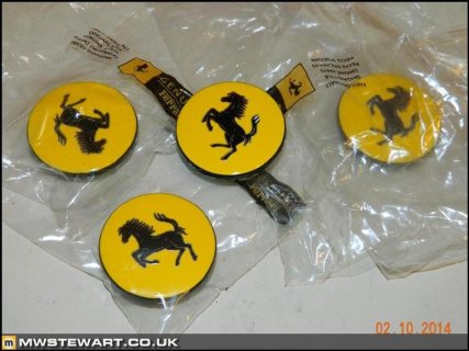

My car had the 'early type' wheel centres so I ordered a set of the 'new type', which are a darker yellow that is essentially Giallo Moderna, which is a better match for my rev counter and Ferrari bdages.
Fitted.

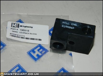

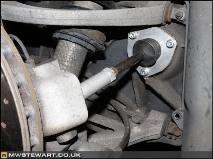

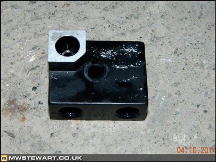

Whilst renewing the brake fluid I wanted to address another potential problem area which is the distribution block for the clutch slave cylinder. The OEM part can suffer hairline cracks which are usually caused by over tightening of the bleed union, but sometimes they can appear on their own. I had also read online that the OEM part was plastic.
To pre-empt any potential problems I bought a Hill Engineering uprated version, which is billet aluminium part, anodised black. Hill were great as usual and worked with me to pin down a postal service that ensured it was with me today - I onlt ordered yesterday, late morning. Thanks Diane!
With a duvet protecting the rear of the car, I leaned over and managed to replace the part from above with the engine bay lid open. It took around 25 minutes to do. The securing hex on the rearmost union was slightly rounded suggesting that the part may have been replaced before, so I may replace that line in due course.

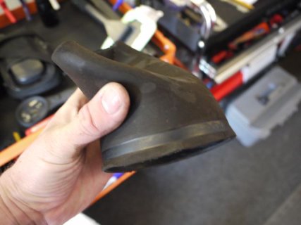

Here's the original part: it's alloy, albeit of a lower grade than the Hill part, and it can be noted that for some reason the bleed union has been milled short which obviously will contribute to a weakness should the bleed nipple be over-tightened.

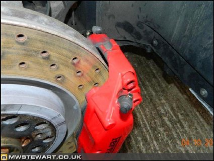

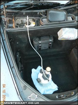

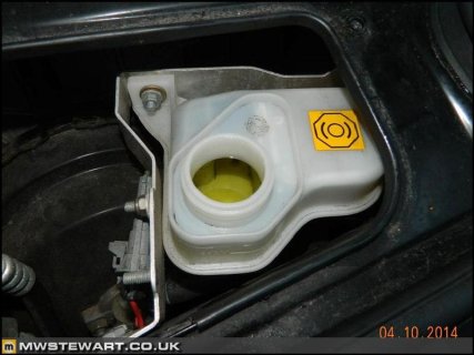

On to renewing the brake/clutch fluid. I use a pressure bleeder as it makes the operation so much simpler.
Calipers are fairly common-or-garden Brembo items with a bleed nipple for each side.
All done. The old fluid in the calipers was very clean so in fairness to Ferrari the fluid had been changed at some point, and it was just the clutch aspect which was overlooked.

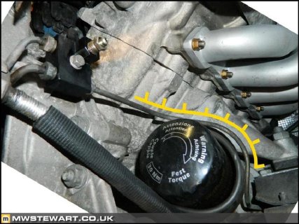

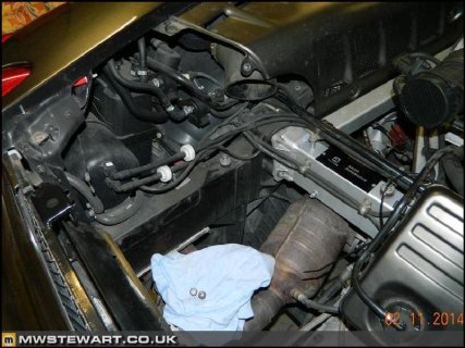

I've done some quick temperature tests in the engine bay following fitment of the aftermarket manifolds/headers, and despite them being coated, temps are in places 50 degrees higher than with the stock manifolds in place. It's not a huge issue, but I'm not happy with it so over winter I will remove the manifolds and send them to be triple coated. I will use http://www.camcoat.com/main/coatings2.html for the work; they offer a 'RaceSpec' version which is a triple exterior coat and single internal coat - which is tried and tested in Le Mans cars - but I'm cautious of introducing any possible failure modes within the exhaust primaries, which is of course the very reason for removing the stock manifolds in the first place, so in view of that I will stick to a triple exterior coat. This should bring bay temps lower than with the very well insulated stock manifolds in place.

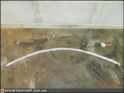

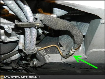

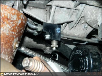

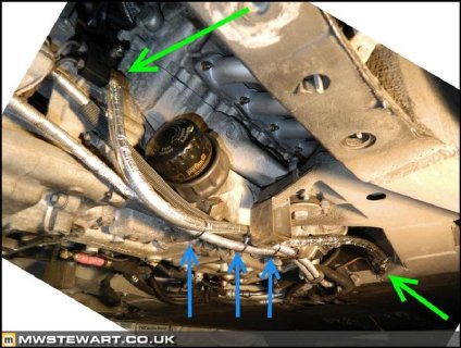

I did mention in a previous post that I would at some point revisit the engine bay clutch line which was knurled at the clutch distribution block end, which is the likely result of a previous clutch block change. Whilst making the line I decided to address another potential problem area: the steel hardline on manual gearbox F430's takes a rather tortuous route which exposes it to the heat of the manifold primaries without the benefit of any heat insulation whatsoever. The orange lines in the following photo illustrate this:

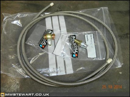

In view of the above my replacement line will be of a different construction and take a different route. Thankfully the master cylinder to slave cylinder line that runs the length of the car is composed of multiple pieces, and the section I want to replace is joined at a very accessible location at the front of the engine:
The hose of choice is -4 Aeroquip PTFE inner/stainless braid covering. I'm using a Banjo fitting at the clutch block end to allow the hose to pass directly downwards from the block.
I have some 'extreme' hear barrier (bottom) that is a snug fit over the -4 hose, and for maximum protection some fire sleeve (top) on top.
Here's the OEM clutch line removed (top) and my replacement (bottom).
Replacement line in situ, showing the new route. Green arrows indicate hose connections and the smaller blue arrows indicate the stainless fixings I used to secure the new line to the gear change cables.
The clutch was bled through and test. Fluid of choice is Motul RBF600

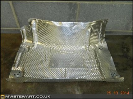

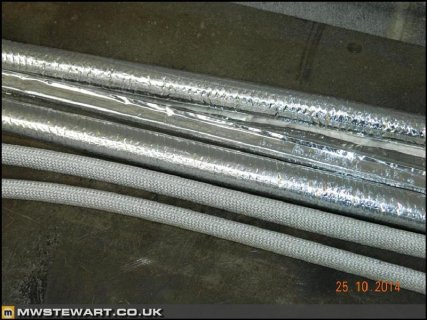

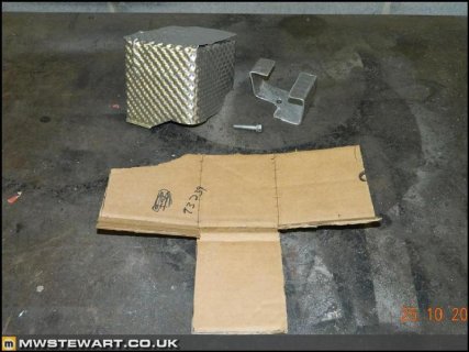

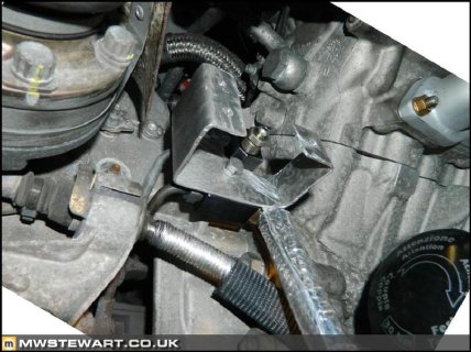

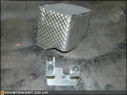

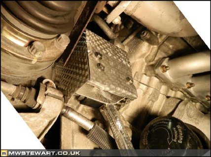

Whilst working on the clutch hydraulic system I wanted to provide some protection for the distribution block. Regardless of what type of manifolds are fitted, the block is within 50mm of the neck of the stock catalytic converter, which obviously is not coated - none of the stock system is - and also falls outside the reach of the stock heat shield. I had noticed that the clutch block can be hot to the touch after a run, which obviously isn't ideal, so my plan was to create a heat shield in a similar vein to the stock part protecting the CV boots.
'Nimbus' was my material of choice, but rather than buy the branded product I located a heat shield on eBay from a mass produced car. It's the same stuff, but brand new only cost a small amount. The part I used was from a Citroen!
A few cardboard mock-ups later I had a pattern that would work. I also fabricated a bracket from 2mm aluminium that would mount to the clutch block and utilise its mounting bolt.
Close up of bracket and shield. The shield looks a little messy here because I designed it with overlapping sections that will be held together by the sheet metal screws used to affix the assembly. I also designed the shield so that overlap join sections face away from the heat source.
Bracket in situ. Clutch bleed block still easily accessible from above, below, and directly in front.

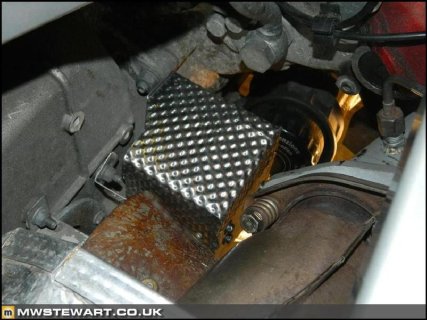

Shield in place. This photos show how it looks much neater once clamped down to the bracket.
Engine bay view. The photo shows how the shield follows the contours of the gearbox, and also just how close the clutch block is to the cat.

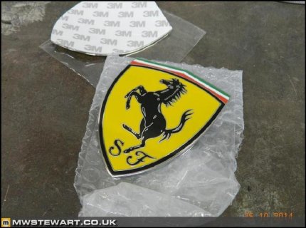

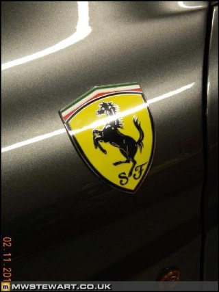

Wing/fender shields courtesy of Denver308 on Ferrari life. These are a high quality replica of the OEM shields.
My temporary gel badges removed and replaced with the high quality versions.

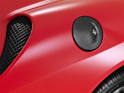

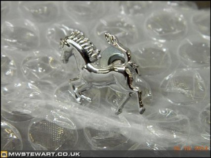

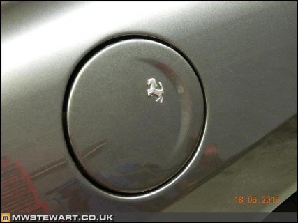

Another cosmetic detail I really like was the Cavallino Rampante ("prancing horse") that comes fitted to the optional carbon fibre fuel flap.
I'm not really a fan of the contrast of CF in the middle of a panel hence I didn't want to fit the entire accessory flap, so I tracked down a genuine Ferrari prancing horse in the correct size which I will affix to the standard fuel flap.

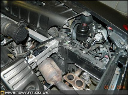

My plan of attack is to leave the transmission within the engine bay and simply slide it back to provide access to the bell housing and flywheel. I will support the transmission with a hoist or a transmission jack/cradle. I am quite sure I can complete the job without removing the transmission support frame.

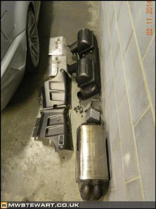

To start I removed, in order:
- Left and right rear side panels;
- Exhaust silencer - the studs snapped which was expected;
- Airbox;
- Catalytic converter heat shields; optional but provides more visibility of the transmission;
- Transmission mount heat shield.
This provides the following clearance - right side:
Left:

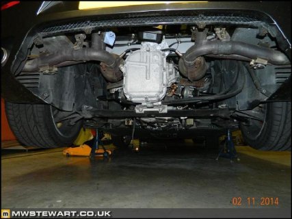

Overall view. I have placed some cloth underneath the header tank to protect it.

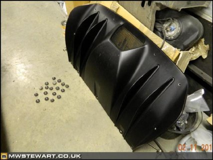

Rear diffuser removed.
Car jacked up and under tray removed. I have this off to a pretty fine art now: 15 minutes or less.

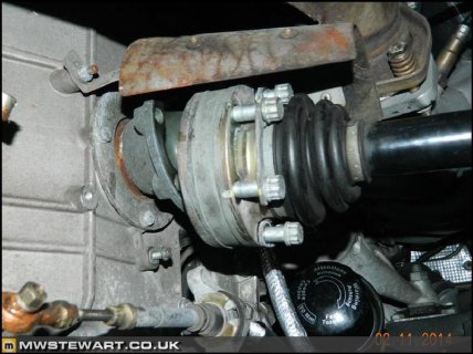

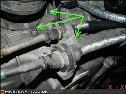

Gear change cable ball joints disconnected from mechanism, and cable bracket removed from the gearbox with cables attached. Three of 7mm nuts.
Driveshaft CVs unbolted. 13mm 12 point nuts.

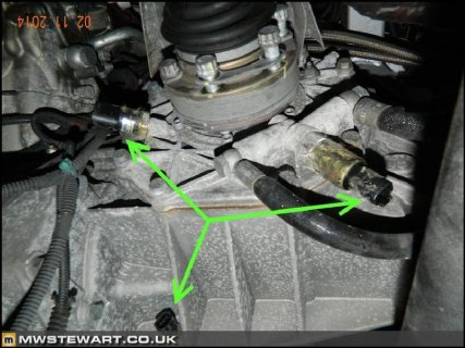

This next job was the worst so far. The E-Diff solenoid and sensor multiplugs are covered in adhesive foil-backed fiberglass heat insulation. The insulation has to be carefully cut off as it can't be removed in one piece without risk to the fragile cables underneath, so as a result one needs to be careful of many fibreglass strands which are liberated once the foil backing is cut.
The car is a pleasure to work on. Some of the trim items are flimsy as I previously noted, but the mechanicals are well laid out and there are levels of space around the components that would be a pipe dream when working on a regular vehicle.

Nice work and very good detail. :thumbsup: I'm interested in providing better heat protection within the engine compartment and will be obliged if you could give details of suppliers for the Nimbus product and the insulated conduits.
Many thanks Geoff
Many thanks Geoff
Thanks Geoff. I purchased a Citroen heatshield on eBay: a lot of manufacturers use Nimbus for their exhaust shields and I've found these the cheapest way to get the material.
Mark
Can you tell me how you sourced this Prancing Petrol Cap Horse. What a great idea, looks fabulous.
Thanks Phil. Again that was from eBay. Eurospares amongst others sell the genuine item in various sizes. It can be harder to locate the version with attached stud, but you may well perfer to bond on rather than drill/bolt, which is what I did.

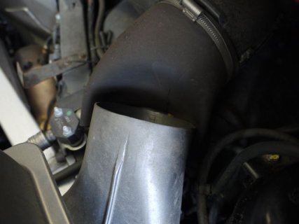

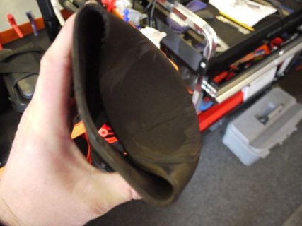

On the subject of dealer servicing imagine how my engine was going to fare after this handy work from Maranello Egham who changed the headers and left the air intake on the rightbank like this..
Lazy, crap workmanship, yes its hard to connect the airbox but that's why we pay you what we do for labour - you are supposed to be the best.
Luckily some boiling water was enough to reform the pipe but imagine the mysterious faults this would have thrown up and if left undetected long term issues..
Needless to say I will have my service history done by official dealers, e.g. oils, filters etc. but any advisory or remedial work will be done at independents who care and do better work.

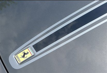

Monday 22nd December 2014
I think I've tracked down some 16M wheels but the postage from USA isn't cheap. I have decided to add the skirts and front bumper too:
and the regular stripe:
I'll leave the back end standard as I actually think it looks better on the F430.

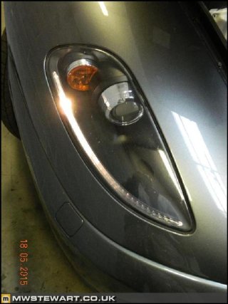

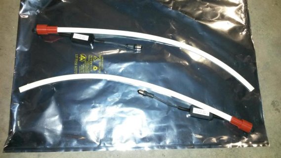

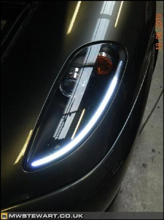

The latest version of Scud Ing DRLs
Which do this:
I have next week off work to tinker with the cars and hope to get everything fitted. I miss driving the thing now - speaking of which we have a road trip planned for September. My girlfriend has been excitedly planning some of the finer details:

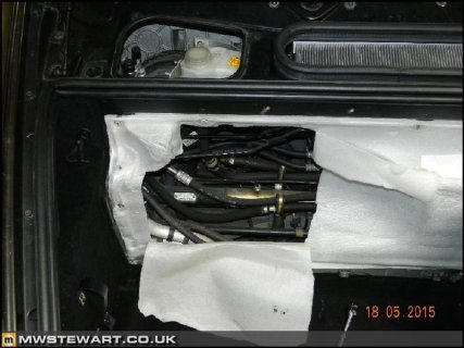

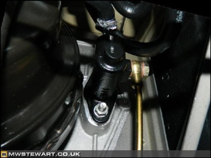

Updated Clutch Master Cylinder 180841
Today I fitted the updated clutch master cylinder to address the issue with the old unit (175187) identified in recall R/2006/210 - https://www.theaa.com/allaboutcars/...430&modelName=F430&makeName=Ferrari&makeId=B2. Access is via the luggage compartment and through a waterproof membrane, which must be cut then sealed up once work is complete.
Replacement was straight forward, just a bit fiddly. I used new crush washers, clips, and hose.

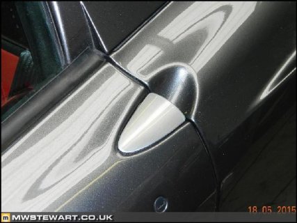

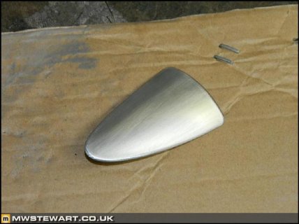

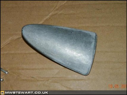

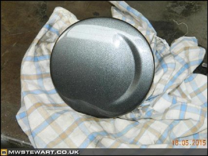

Titainum Look Door Handles
I really like the titainium door handle official accessory: http://www.meridienmodena.co.uk/titanium-door-handle/ I have been contemplating these for a while, but at £500 I keep thinking the money is better spent elsewhere. Today I removed one of the handles to have a look how they are made and I was surprised to find they are actually cast alloy and not plastic like I was expecting. I decided I could do something with them! I used paint stripper to remove the factory paint and primer, leaving the cast finish:
Next I used different grades of went and dry paper to achieve the machined look of the accessory handles.
Finally I lacquered them. Here they are:

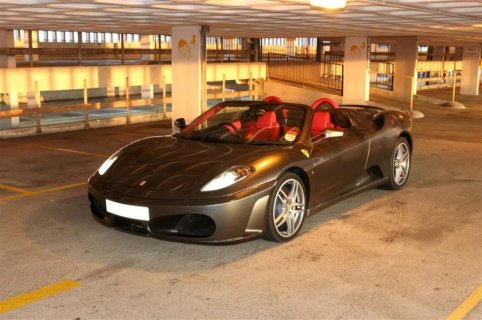

ILUAL43 Headlight LED DRL
I fitted the new version of ILUAL43 Headlight LED DRL from Scud Ing. Here's a standard sidelight for comparison:
And the ILUAL43. In person they are incredibly bright.
Fuel Flap Cavallino Rampante

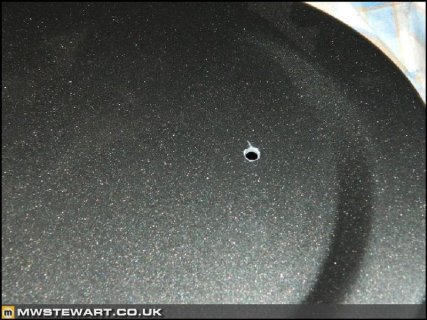

Finally today I got around to modifying my fuel flap with the bolt on Cavallino Rampante I bought last year. I'm not a fan of exposed carbon on a Silverstone car but I really like the prancing horse on the accessory carbon flap, so modifying my standard flap seemed the ideal compromise.
I marked on the flap my preferred position then drilled a 3.5mm hole, and prepared it with etch primer, then a smear of grease over that once it had dried.
Flap back on the car complete with the Cavallino Rampante.
Prancing Horse
Mark
Mark
Hi Mark,
Thanks for coming back on this. That is exactly what I'll do and stick it on. If I don't like it after a while it's an easy fix to remove it. Not sure I could do what you have done to your door handles though. Brave, but I guess a fairly easy change back if you end up not liking it.
Love what you are doing by the way.
