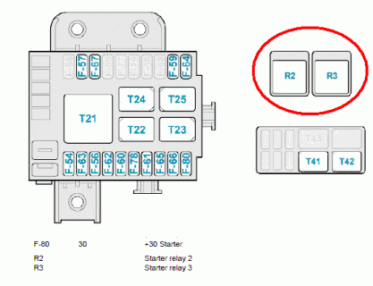

Anyway, you need to find both of the relays listed in the manuals. I suspect that the start relays are these black ones just behind the left hand door:
The workshop manual has this diagram, but perhaps they haven't bothered to angle the starter relays

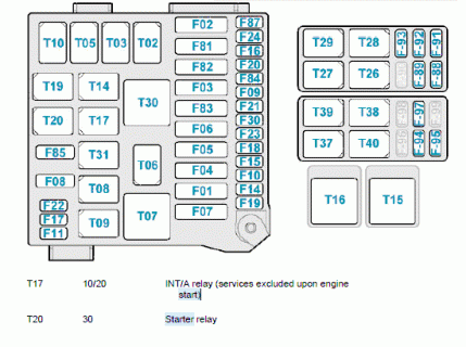

Did you replace the fuse?
I see there are also these relays behind the glovebox.
Is one of these relays the one you removed? The first one just cuts out certain systems during start to reduce the load on the battery. I suppose this could cause difficult starts.

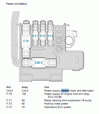

Also, if the battery is not difficult to get to, make sure the nuts on these fuses are tight:
(Caution: Live battery power)

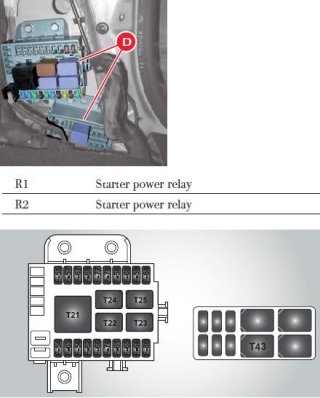

It seems that there are variations between 458's. Here are some shots of my Owner's Manual (slightly different to the WSM).
In my version, relay T43 is shown, but no function is assigned to it. R1 and R2 are mentioned, but not shown in the photo.
R1 and R2 (or R2 & R3) seem to be optional.
Try pulling the blue relay on the lower panel (behind the driver) and see if the starter motor cranks.

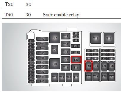

Regarding the glovebox relays. Here are some shots of my Owner's Manual:
T20 is not listed, but T40 is assigned to start. These manuals are hopeless.
Also try pulling T40 to see if cranking is inhibited.

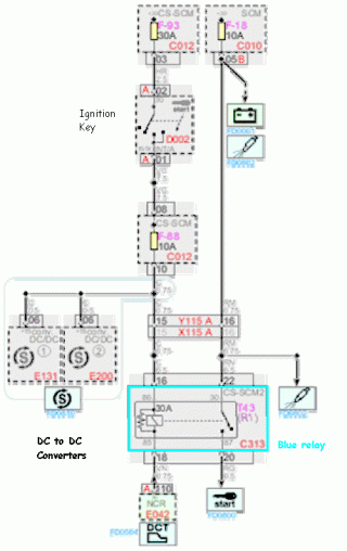

Here's part of the start circuit, but it's not very clear:
The DCT system controls the start relay T43 behind the left hand seat (separate light blue relay)
The Start pushbutton probably talks to the DCT system on a CAN Bus. If start reqirements are satisfied, then the DCT TCU energises the coil of T43.
I don't have any other diagrams with details on the starter motor.
