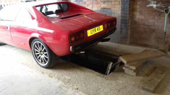

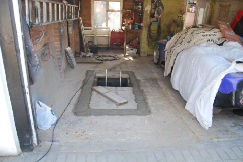

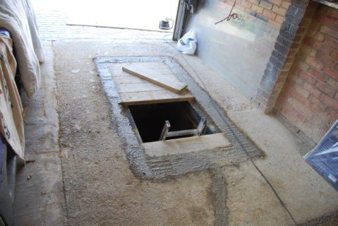

YEH!! No more crawling on the floor under cars, I am now the owner of a hole in my garage floor :D
Concrete is still a bit wet; but well chuffed!

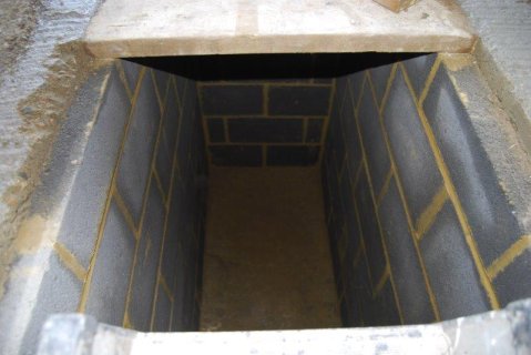

yes guys, constructed of 6" blocks, and backfilled with concrete. Its not V long, but as neither of my cars have anything in the middle and have rear engines I'm not that bothered :)
Plenty of ventilation! I just open the garage door..

Just as a suggestion - on my dads at one end he had done an extra row of breeze blocks which acted as a step into the pit (which you could also sit on for a breather) which mitigated the need for a ladder. If you have any blocks left over might be worth putting a "step" in.

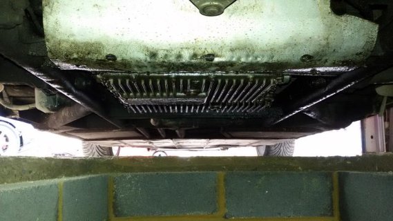

Today I tried the pit out and adjusted the handbrake on the 308, so much nicer than using a jack :) The pit could probably do with being a couple of feet wider and a couple of inches deeper.
But still well happy.
