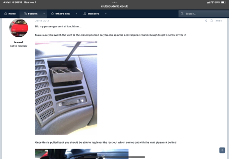

Did my passenger vent at lunchtime...
Make sure you switch the vent to the closed position so you can spin the central piece round enough to get a screw driver in
Once this is pulled back you should be able to tug/lever the rest out which comes out with the vent pipework behind
Lever the vent flap control apart to disconnect it and then you should be able to lever/pull the pipework off - this seperate bit although "sticky" just needs a clean in detergent.
Lever against the inside and you should be able to pop the center vent unit out
Just gently pull the stay off the back of the flaps then pull each flap off one at a time - pull straight back so you dont snap any of the locating pegs

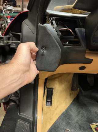

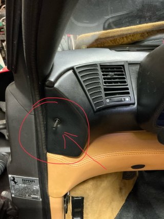

I found it was much easier to remove the side trim first before trying to remove the vent. Else is too easy to break the plastic clips. Removing the side trim is simple, it’s one screw and it comes off.

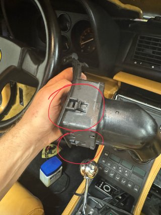

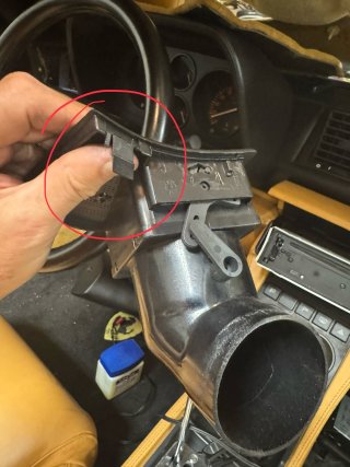

There's 4 tabs on them holding them in - Ill take a pic tomorrow and post it up - I just used slot bladed screwdrivers to ease them out.

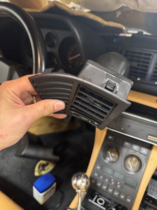

Mine were not so easy to remove. I found taking out the screw holding the side dash panel in place made it a bit easier. With the side dash panel loosened up, it was easier to get the vent out. Here are some pictures which may help you out.
I could not get the screwdriver into the front of the vent to pop the clip loose to remove the vent as shown in this picture. My vent would not rotate up far enough (even with the vent closed ) and I was afraid I was going to break the plastic clips. That’s why I loosened the side dash panel. After gentle pressure and turning 90° to the left, the vent came out.
