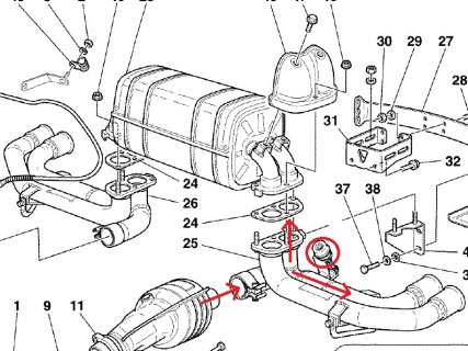

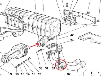

I've got a feeling the system for the 348 was not as clever as that. If you look at the pic below the only valves are on the exit pipes AFTER the cans.

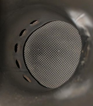

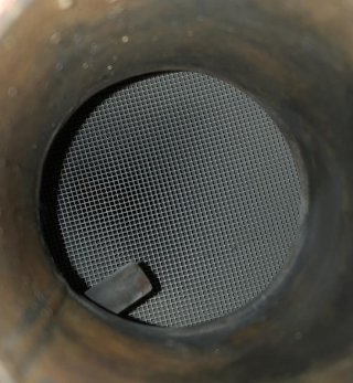

After Adrian's comment on another thread about modern high flow cats making very little difference over straight pipes I'm wondering what the old system but with modern high flow cats would sound like?

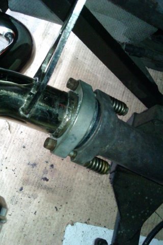

My exhaust is off just now for the clutch, its a tubi or quicksilver, not sure which, but takes longer to get the car on axles stands than to take the exhaust off. 8 bolts from memory, 4 to the cats and 4 to the mounting.
Those new donuts are cheapest from superformance, but I'm sure if you hunt around you can find them even cheaper. I've got a set at home waiting to put the clutch back in, so I'll measure them and maybe Jeff's star google searches will find them; I cant believe they are really £8 each! Just don't over tighten them.

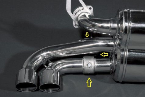

The modern cars '360-onwards' only have 2 valves to my knowledge. I believe the principle of operation on Valvetronic exhausts remain unchanged...
I'll try and find a photo to help clear this up when i get chance later (currently at work) but the earlier silencers had a 'over complicated/engineered' design which I can only assume was for asthetic purposes only. The re-routing or 'silencer bypass' pipe for the second tail pipe was hidden within the nice shiny aluminium or stainless silencer cladding...
On the later cars (F430-onwards) this 'bypass' pipework is external of the silencer which resulted in the silencer internals requiring less chambers and pipework within which ultimately resulted in the reduction in silencer dimensions and a weight saving too.

Anyone have an opinion on what the old system but with modern high flow cats is likely to sound like? Don't think I've ever heard of someone de-catting a standard system which I guess would be similar.
Although thinking that last bit through, some early cars didn't have cats so I guess there are some out there like that.

I imagine you would retain a mostly stock sound replacing the stock cats with sports cats. Decat would likely alter the stock sound a little. Each option would assist the having its voice heard.
I guess taking a punt on either would be a cheaper option than purchasing another silencer. If the desired result isn't achieved you could always revert to the idea of upgrading to a valvetronic setup and sell both your recently purchased cats or decat pipes and the Supersport silencer to offset some of the cost...
I cant imagine your Supersport silencer or the new sports cats / decay pipes causing many headaches to sell on for a decent price via fleabay or the forum Pete.
