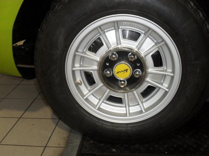

Sorry, of course are Cromodora not Campagnolo! Are they a magnesium alloy? Spoke to a local wheel refurb company and they didn't want to touch them. Help please, on how to go about refurbishing them and correct paint code? How to protect them when painted, if not by lacquer?
Speak to Pristine Wheels in Milton Keynes. They are used to dealing with magnesium wheels and offer a wheel collection service. They have just refinished a set for me (Carrs in Exeter organised it) and the colour and finish are excellent. They will use a satin laquer to protect the paint and which gives the correct non glossy original look finish. Here is one of the wheels they did for me. Just tell them you would like the wheels refinished to the same method they used for Carrs back in February. The paint used was FIAT Argento 612/A in D/W shade.

I have arranged for Pristine to collect my set for refurb. I note you are using metal valves rather than change to rubber. I suppose this depends on the condition they find when theyremove the existing valves?
Also no outside balance weights, so on inside only. Is there sufficient clearance for stick on weights to be used on the inner circumference or should they be avoided and only knock on weights on the inner rim?

Weights on the outer face are just a pet hate of mine as they ruin the look of the wheel and are a potential point for corrosion on the magnesium when removed. There is sufficient clearance for stick weights on the inside of the rim which is a much tidier solution. The metal valves are there because that is how the cars were supplied when new.
