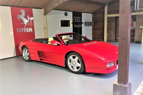

Hi all,
Ref: 1994 348 Spider, Rosso Corsa / Crema.
I've read a few threads on full resprays (in particular regarding a 308 back in 2006), but wondered if anyone had any more recent experience, or indeed tips on what to do and what not to do. I noted some advice regarding the decision to go with a fully invoiced job for example, versus a cash purchase. Likewise, I learned a lot about the snags encountered by unexpected parts replacement, where things either got broken on the job, or which needed replacing to retain the same level of finish as the paintwork itself.
FWIW, I was anticipating getting the front splitter, bonnet and 2 wings done. For reasons I won't bore you with, 2 years ago I got a £2K quote from near Fairoaks airport (for anyone who knows the area), but circumstances meant I had to put it off. I'm now considering doing it at the end of this Autumn, and last week I got referred to another very nearby alternative (by Foxhills golf club), and they're adamant it needs a complete respray all over. Naturally that whacks up the cost, but despite being a thoroughly reputable supercar paint shop, because they've never done a 348, they're being very broad on their projected quote i.e. "...bottom end £5K, absolute top end £10K".
I'd be grateful for any advice, so my thanks in advance.
PS - I'm a rookie at these things, so if you can restrain from beating me up too much, I'd appreciate it.

I'm sorry I can't help but at the risk of this sounding like an odd question, has your garage got Ferrari signage of some type on the exterior of the doors?
Hi Mark - yes mate :thumbsup: One of the many results of: 'what shall I do today?' recuperation and Lockdown. So next time you're out walking, say hi (assuming that's how you knew ;-) )
I'll do that! Yes, we were out walking and passed you back in April. I took a picture but didn't want to post that on a public forum :)
