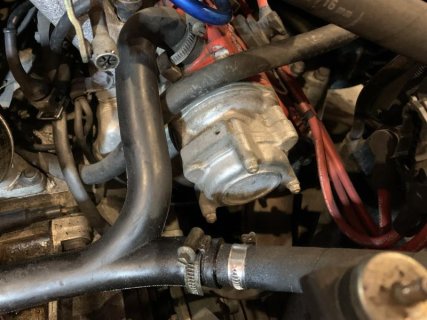

Decided to change my phase sensor so ordered one from Maranello

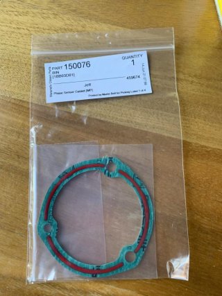

Just to cover myself in case I find oil in there I bought a replacement housing gasket and oil seal

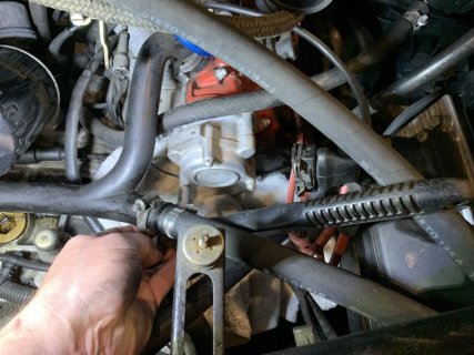

With the air box removed and out the way it's just 3 x 8mm nuts to remove
Its a bit awkward with other things around it so once I'd used a ratchet to crack off the nut I just used the socket in my fingers to get them off.
There's also a washer too so make sure you get that off too so it doesn't get lost.
Once the 3 of them are off it's a case of pulling the cap off - I actually needed 2 hands to do it as it requires some force and rocking slightly from side to side to get it going.
The phase sensor actually comes as 2 pieces but I decided to leave the inner part alone as it's a none wear part and a case of it ain't broke so don't fix it. I ws only going to remove this if I found oil in which case I would be replacing the housing gasket and oil seal too.

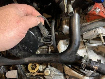

Final step is to unplug the electrical connector.
When i put the new and old side by side I noticed that the lead on teh new one is a lot shorter and I was thinking I might be in trouble but it proved to be a non issue as there's plenty of spare capcity lead wise.
