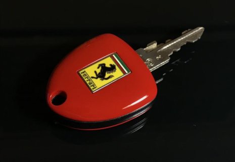

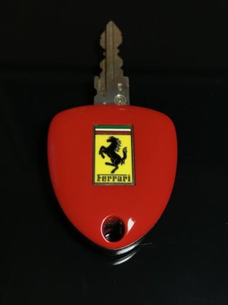

The results were superb giving a lovely even finish, almost to the point I didn't need to polish it.
However if you're going to do a job properly..................so I flatted it back with 5000 grit - more to de-nib than anything - and two stage polished it using my Rupes Nano.
Lastly I applied some Meguiars ultimate liquid wax.
And here are the results. Which are night and day compared to the first attempt !
