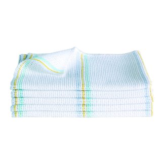

Firstly, you will need a pack of lint free, open weave dish cloths, a 15 inch (8mm diameter dowel - the length is critical) and a retrieval tool to pull the cloths back out (This is a flexible tube with and actuating rod down the middle and a retractable claw grip on the end).

4) Using the dowel, carefully introduce one of the cloths into the light housing through the bulb hole
5) Once the cloth is inside, use the dowel to sweep it around from side to side - the open weave will pick up the debris beautifully

The cloths are easily available in Lakeland although I found I had to cut them in half to get them through the whole.
