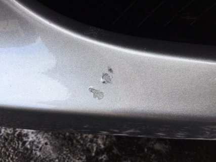

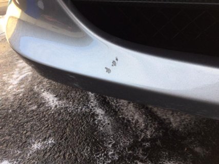

I could do with some advice in this department too. Picked up these belters recently :cry3:

Considering trying chipex..?
Mike, Chipex is OK, one trick I learned was to warm the paint before application, get a much better finish
Dermot, Not sure if Spraymaster can help or maybe you need to find the nearest match in normal paint, most decent paint shops now have a 'reader' to identify the paint colour and match it

Looks like something tried to hold on with their teeth Mike.
Which paint did you warm Mark, stuff in the pot or the paint around the chip? Currently painstakingly going through my welsh weekender chips with Chipex but getting mixed results.
stuff in the pot :thumbsup:
