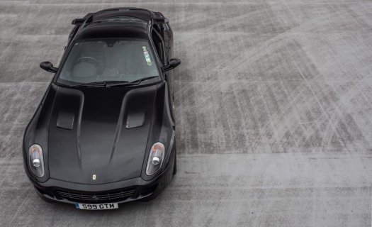

So my ultimate project goals are settling down now and this car is a hint at my final goal.

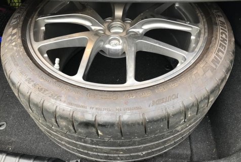

Again my rules are Ferrari only parts BUT make something unique and optimised for fast road work. The front of this car is a little too aggressive to my tastes but some additional front aero is on the cards. The FXX buttresses are a must as I love the self stalling aero and the way it changes the rear aesthetic to something uniquely functional. The factory have agreed to me fitting a set but they will be being made to order. Today I scored a set of GTO wheels which allow for a generation better tyre fitment (MPSS) and a big increase in contact patch front and rear. The tyres that came with them paint a sorry picture of GTO ownership. These are 8 year old tyres anyway so will be binned but just look at how hard they have been used...

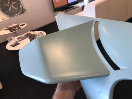

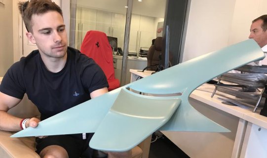

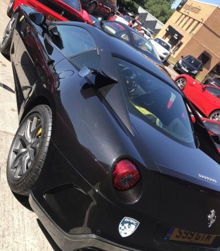

The part in question is the first generation 599XX air guide blades which are there to give additional rear axle downforce specifically at a certain speed range. Having driven my 599 hard now for 12k miles and knowing a bit about aerodynamics I know exactly why this appears on the XX cars.

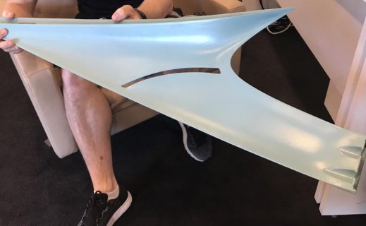

Here are some more shots:
Rear winglet with downturned fence to hold air on the wing...

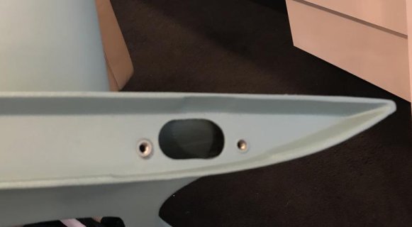

Backside shot
The air bleed slot is very important to limit the effect of the winglets downforce above a certain road speed
The parts are fully hollow hand laid carbon done in VERY low volumes hence the finish is typical F1 car finish.

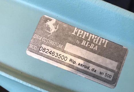

XX parts are only orderable by XX owners and chassis numbers so this is where factory contacts help and the mods are being done with full support from the factory.
See next post for why...

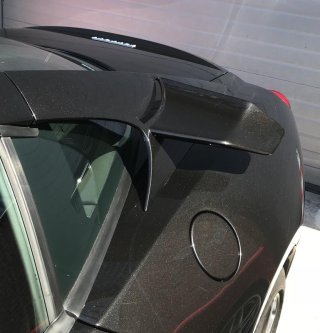

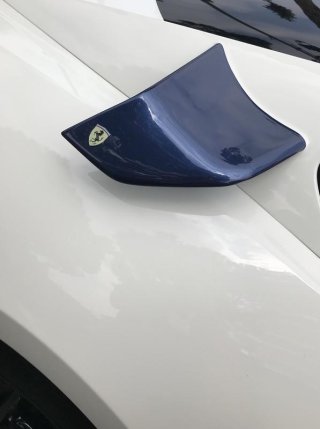

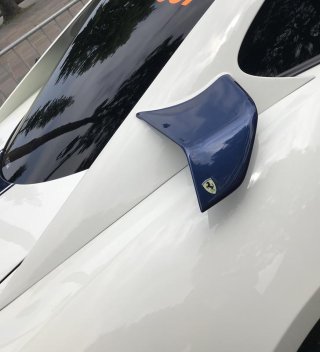

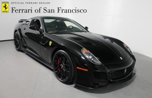

...So look closely at this 599 GTO it has the XX blades right?
Wrong - they are fake
This winglet does not have the air bleed slot and so instead of having a limit to its effect to solve the specific issue it was designed to it will keep on working when not designed to and actually create front end lift at very high speed. The car was on this years Tribute and of concern to the Ferrari Technicians who mentioned it to the owner. The fake parts are also heavy and add weight and the real parts are ultralight and produce an effect specific to the rear axle centre line.
This is why my policy is always genuine parts unless you have something that is measurably better. These fake parts are a good example of modifying that makes things worse. Would not like to drive this car above 120mph

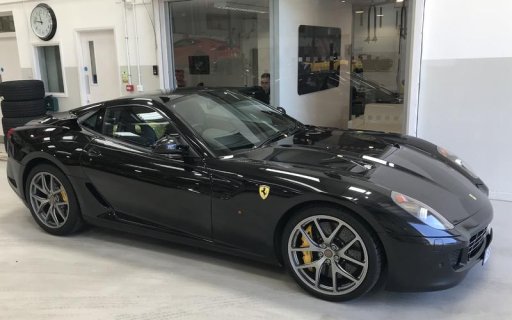

So the Beast of Brescia reaches evolution #3
New windscreen, New wing mirror casing, GTO wheel set with MPSS, FXX rear pillars.
We also changed the oil after the Mille Miglia and did a full traffic light check - all green.
I am really really pleased with the look and especially the wheels which I wasn’t sure about. I think it needs a front splitter to complete so am sketching some designs as we can’t find a track aero pack one for the gtb. The rear aero parts needed a lot of paint prep to reach a high standard of finish. Many XX parts are racing
Vehicle finish. Annoyingly we forgot to weigh the parts but just in your hands it’s a few kilos out. Tyres are old and although stored in a dark cupboard for some years I will refresh them next year.
