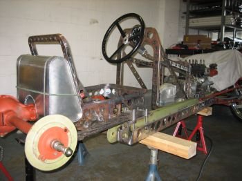

This is the current project, I don't think too many will be interested in this but I have been asked to post a few pictures!

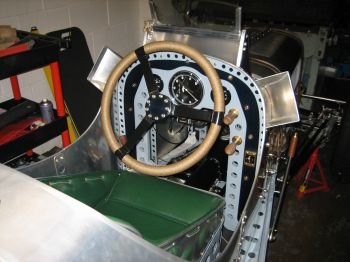

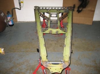

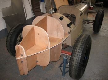

Car is about 95% scratch built, pictures are in no particular order, just to show some of the process involved.

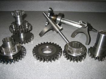

A few more...

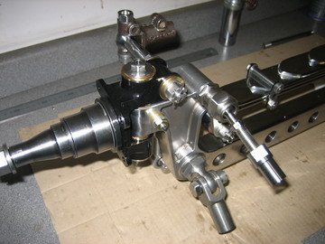

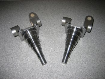

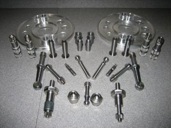

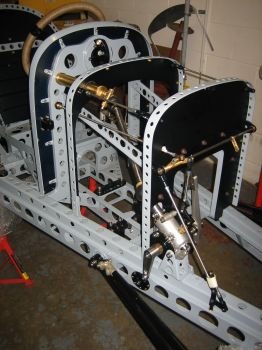

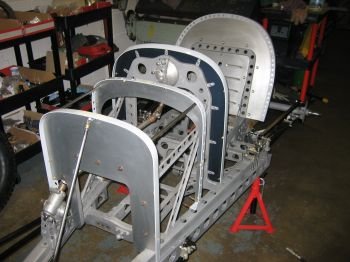

Thanks for all your kind words, much appreciated. A fw more pic's below, again in no particular order. Although I've made many parts on modern machines, no part has been drawn that could not be manufactured on manual machines as available pre-war. In away this helped the design asit prevents you being too extreme.

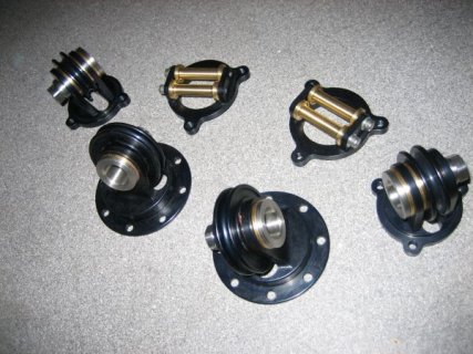

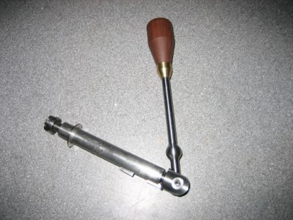

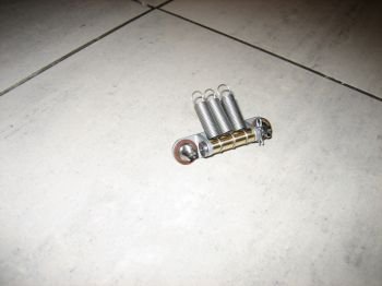

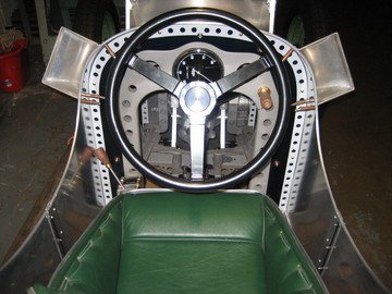

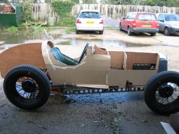

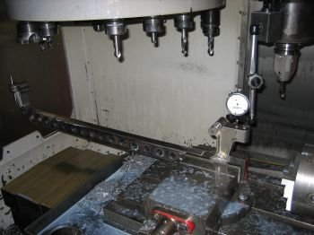

When scratch building a car you get to a point that looks about 80% complete quite quickly (perhaps 1 year), but its the details that took the time. Below are two photos, one of the gear lever and another of the pulleys that guide the brake cables. Important parts but just small details. Every part of these started as a solid lump of aluminium, steel, wood........ First you draw it, then you machine it, then you assemble it! The gearlever alone took about 3 weeks of spare time, its not my full time job, just a few hours here and there!

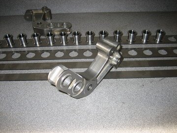

The 3rd pic are the brackets that tension the leather bonnet straps, there are 4 off them, each one has 3 unique parts and bolts and washers all machined from solid.

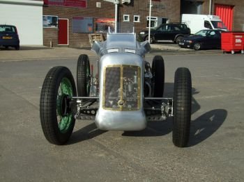

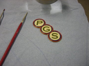

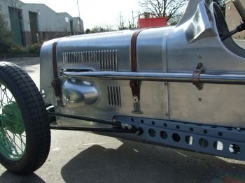

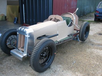

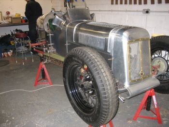

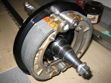

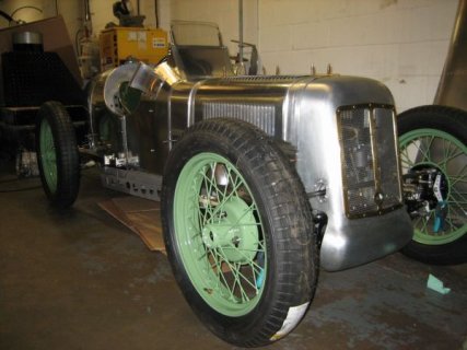

The car is approaching completion as shown in the first picture, the others show the rear brake shoes, originals didn't fit my axle mods, so had to make new ones, the car willbe called the "Pea Green Special" so the badges are again machined from brass and hand painted.

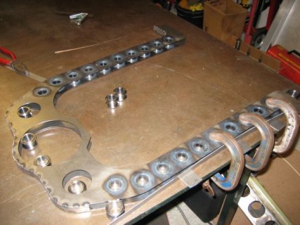

Final picture shows the front bulkhead during fabrication, all the bulheads appear solid but are hollow fabrications, machined bobbins sit between 1mm steel frames. Alot of welding has been completed.

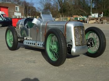

The car had its first roll out today, all the major work is complete but alot of details to finish, next job is the starter motor, then radiator, then start up! After that make a propshaft and a test drive.
Brakes, clutch,throttle, air pump, advance/retard, gearshift are all operational.
