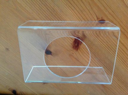

After a few drives this year, the 355 is missing a key piece of motoring kit...cup holders!!!
I’m certainly not brave enough to put my coffee mug between my legs and go for a drive.
Knocked up a quick trial. We will see how it goes and if it works I’ll probably make one out of wood this winter and cover it in some leather I have left over from doing the dash.
